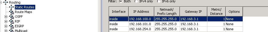

Also, would this static routing be configured correctly when our DHCP addresses are 192.168.3.X.  As mentioned before my networking skills are lacking and the person who set this up is long since gone.
