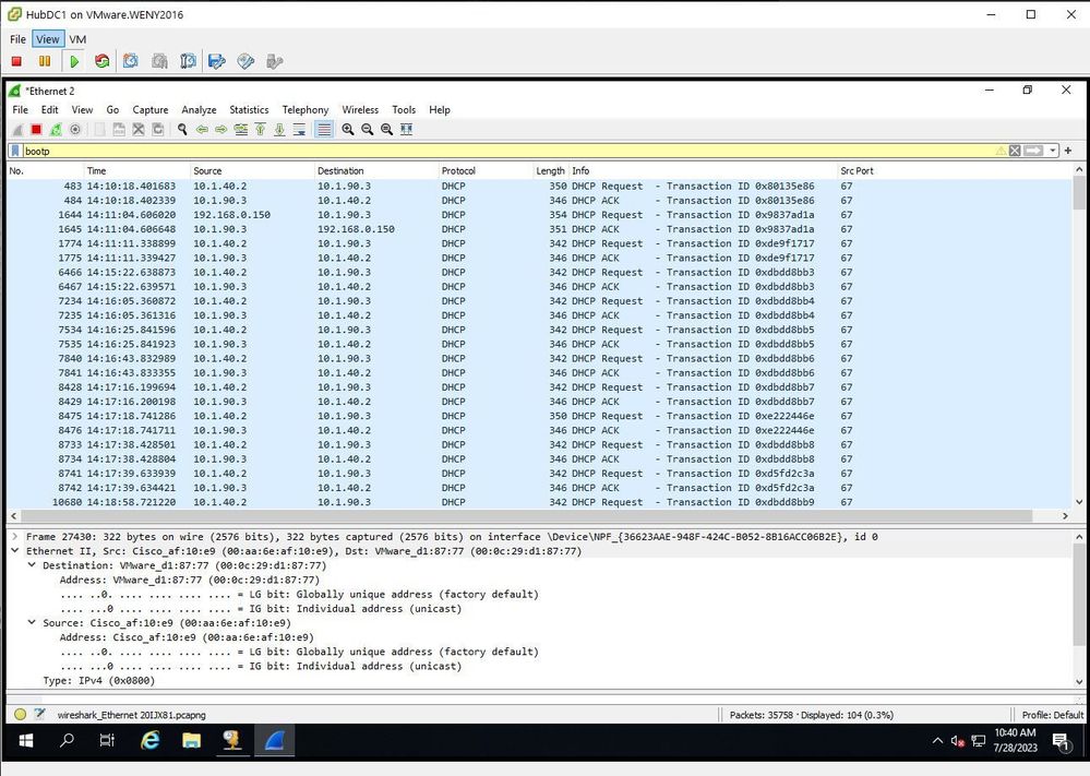

   I've spent about 2 weeks reading threads on this subject but I've yet to find what solves my issue. We recently have an issue where our VLAN1 stopped doing DHCP, well, not entirely. Sometimes it takes a long time for an IP to be issued, or not at all. And sometimes it issues an IP that's already in use even though most of the IP addresses are available. The configurations we're using have been in use for years; we've had this problem maybe twice in the past but a core stack reboot would typically clear it up. We deleted exclusions (bad idea) as I assumed having reservations was sort of the same thing; they've been re-added so no more conflicts. My laptop is connected to a small switch, which is then connected to our Admin Core stack of 3 9300-48T's (16.8.1a). An ipconfig /renew does nothing but return an error it couldn't find our DHCP server. I'm trying to get an IP from our scope (192.168.0.1-254/24) from default VLAN1 (192.168.0.150) to our DHCP server VM (10.1.90.3). The DHCP Server VM is on a VMWare machine; this VMWare machine has two Nics occupied and each are a trunk with all VLAN's. Our Sonicwall Firewall is 192.168.0.1, our switch stack is 192.168.0.150 (if it even should be) and our DHCP server vm is 10.1.90.3.

Hi @mlord ,
So, this capture proved most insightful!
Indeed, the PCAP from the switch was filled with 50MB of transit data within mere 0.2 seconds. Such amount of traffic hitting the CPU is absolutely abnormal; a switch should not be handling transit traffic at all in the CPU.
It took me a while to understand why this was happening: The hosts we see in the PCAP from the switch are from VLAN1 and its address space 192.168.0.0/24 and obviously they are using the switch - the 192.168.0.150 - as their default gateway. However, the switch itself has its default route configured to point to 192.168.0.1. Hence, the traffic from hosts in VLAN1 and destined to internet is getting "tromboned" or "hairpinned" - it comes to the switch through VLAN1 and the switch needs to send it out through VLAN1 again to 192.168.0.1.
Now, IP rules dictate: Whenever you need to route a packet out the same routed interface that you received it on, you must also send an ICMP Redirect to the sender to inform it that it can save one hop by using the proper gateway directly.
And this is the problem! With hardware-based switches, ICMP Redirects are generated in the operating system of the switch, not in its switching/routing hardware, and so for the switch to be able to generate those redirects, the hairpinned traffic must be punted to the CPU for the operating system to see it and generate the ICMP Redirects. This is why the traffic from VLAN1 exiting toward internet is badly hammering your CPU on the switch, causing it to not have time to process more useful traffic in VLAN1 - like your DHCP clients, for example.
It's clear that the end hosts do not honor the ICMP Redirect messages originated by the switch because they are not changing their routing - they're still blasting the traffic across the switch. Ignoring ICMP Redirect messages is the usual behavior of today's operating systems, so no surprise here. Hence, while the proper solution would be to fix the routing on the hosts inside VLAN1, it may not be easily possible, and as a quick interim fix, we can disable generating the ICMP Redirects in VLAN1. This will prevent the switch from punting the traffic to the CPU.
The interim fix is easy:
configure terminal
interface Vlan1
no ip redirects
end
Please try to configure this and then try getting an IP address from your laptop in VLAN through DHCP again.
Best regards,
Peter
