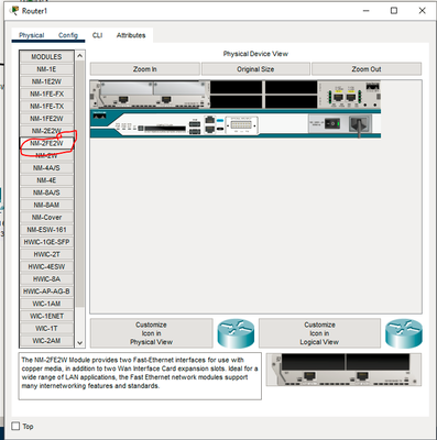

Use 2811 with module NM-2FE2W. Will give you 4 interfaces.

10-28-2024 07:43 AM
Thank you.
Should I use a 2911 router in a private network? We just have one unused gigabit interface
We still need to justify the reasons for using these versions of devices in the work. I don't know how to do this yet

10-28-2024 11:29 AM
I think my teacher will ask me to explain why this or that version of router and switch
It seems to me that the PT router is old and it is better to use 2811. But it does not have GigabitEthernet. What would be better for a private network? To use the PT router with gigabit ports or 2811 with fast ethernet?
And for a public one, leave 2911 or use the one that will be in the private one?
