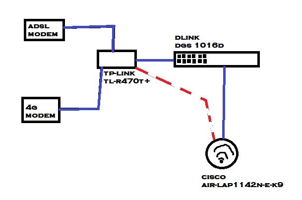

Dlink switch doesent connect to AIR accespoint
I have a broblem connecting my accespoint to my network via switch. I used to have the accespoint directrly connected to the TP-LINK load balancing router and it worked fine, but now I have ro use the Dlink switch and it does not want to connect to it. No lights are turning on on the switch when the AP is connected. I also tried plugging older switch between the AP and Dlink and with that the connection were made, but I'd like to have less parts in the system, if possible. Is there some identification protocol to change to have the AP connected to the switchCould it be that the POE injector is too low quality and Dlink doesn't want to connect to that? But any other switch or modem/router connects to the AP OK?
