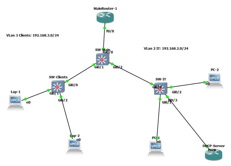

I'm new to networking and GNS3 so please correct me if I'm wrong.
All Switches are CISCO IOSvL2 appliances
I'm trying to get DHCP requests across vlans, my DHCP resides of VLAN 2 IT whilst the client computers reside on vlan 3 Clients which are trying to request DHCP access
 It seems That the DHCP Server Discover packets are reaching the DHCP-Server however the Reply that the DHCP server sends is not forwarded from the SW-IT to SW-Main
Attached is the Packets intercepted from the DHCP-server to the SW-IT then  SW-Main
Configuration Dumps
For the sake of troubleshooting I'll dump all my configs here
Main Router Config Dump
MainRouter-1#sh run
Building configuration...
Current configuration : 953 bytes
version 15.2
hostname MainRouter-1
boot-start-marker
boot-end-marker
no aaa new-model
no ip icmp rate-limit unreachable
ip cef
no ip domain lookup
no ipv6 cef
multilink bundle-name authenticated
ip tcp synwait-time 5
interface FastEthernet0/0
 no ip address
 duplex full
interface FastEthernet0/0.2
 encapsulation dot1Q 2
 ip address 192.168.2.1 255.255.255.0
 ip helper-address 192.168.2.2
interface FastEthernet0/0.3
 encapsulation dot1Q 3
 ip address 192.168.3.1 255.255.255.0
ip forward-protocol nd
no ip http server
no ip http secure-server
control-plane
line con 0
 exec-timeout 0 0
 privilege level 15
 logging synchronous
 stopbits 1
line aux 0
 exec-timeout 0 0
 privilege level 15
 logging synchronous
 stopbits 1
line vty 0 4
 login
end
SW-Main Configuration Dump
SW-Main>en
SW-Main#sh run

SW-Main VLAN table Dump
SW-Main#sh vlan
VLAN Name                             Status    Ports
1    default                          active    Gi0/3, Gi1/0, Gi1/1, Gi1/2
                                                Gi1/3, Gi2/0, Gi2/1, Gi2/2
                                                Gi2/3, Gi3/0, Gi3/1, Gi3/2
                                                Gi3/3
2    IT                               active
3    Clients                          active
1002 fddi-default                     act/unsup
1003 token-ring-default               act/unsup

SW-Main trunk Configuration
SW-Main#sh int trunk
Port        Mode             Encapsulation  Status        Native vlan
Gi0/0       on               802.1q         trunking      1
Gi0/1       on               802.1q         trunking      1
Gi0/2       on               802.1q         trunking      1
Port        Vlans allowed on trunk
Gi0/0       1-4094
Gi0/1       1-4094
Gi0/2       1-4094
Port        Vlans allowed and active in management domain
Gi0/0       1-3
Gi0/1       1-3
Gi0/2       1-3
Port        Vlans in spanning tree forwarding state and not pruned
Gi0/0       1-3
Gi0/1       1-3
Gi0/2       1-3
SW-IT Config Dump
SW-IT#sh run

SW-IT Vlan table dump
SW-IT#sh vlan
1    default                          active    Gi1/0, Gi1/1, Gi1/2, Gi1/3

What I'am i doing wrong
Thanks For assisting me
20 Replies 20
post the current configs of both routers...
Main-Router Configuration Dump
MainRouter#sh run
Current configuration : 994 bytes

DHCP-Server#sh ip route
on the main router, change the vlan 2 subinterface back to what it was (no native):
Also, make sure that the switchport connected to your DHCP-Server router is configured as an access port in vlan 2.
You need to be able to reach 192.168.3.1 from the DHCP server.
Thank you very much
The DHCP lab is finally Functional
I can't thank you enough for assisting me
Glad that you got it resolved !
