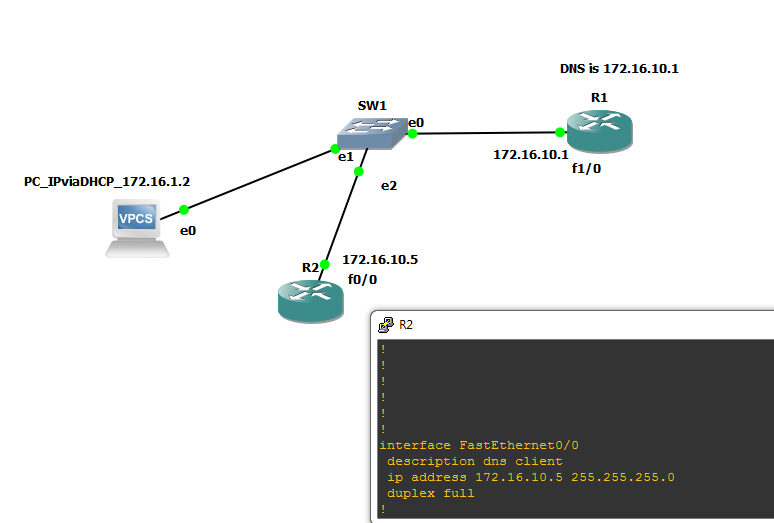

Yes Sir, it does. See attached lab. I was able to ping the hostname of the dns record ns2.test.com instead of its corresponding ip 172.16.10.1. I hope this helps and please don't forget to mark correct/helpful answer. Good luck!
-lab.PNGR1_DNS SERVER.PNGR1_DNS SERVER1.PNGR1_DNS SERVER2.PNGPC1.PNGdns_client2.PNGdns_client2_.PNGAustin

All your questions were specifically about router as dns server config and they were answered by the above lab with requested dns commands as you can see pc as dns client#1 and R2 as dns client#2 both are answering to dns inqury of ns2.test.com.
to verify dns, you can use dns debug command and show hosts
