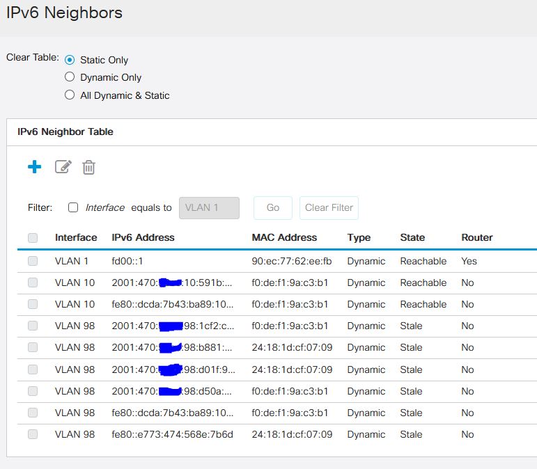

I forgot to add screen captures of my configuration in my last post, so others might check it and propose improvements in configuration if needed. This is my first Cisco switch and I did such a configuration for the first time, so there might be some imperfections that could be improved.
Regards,
Jan
