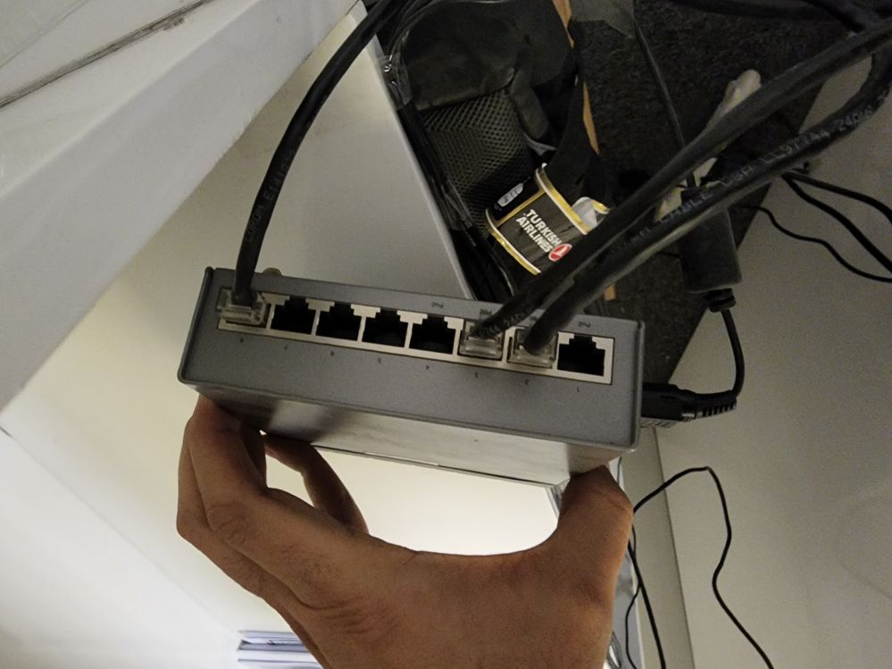

Dear All,
Thank you for all your support, we believe that we found the culprit that was causing this issue. it was small cisco dumb switch hidden in one of the office, this dumb switch was not on UPS, when the power goes out, this switch somehow return a voltage or something back to the main switch causing it to glitch, getting the entire network down. we test it without power outage anytime we plug it in, the whole network goes down.

Dear All,
