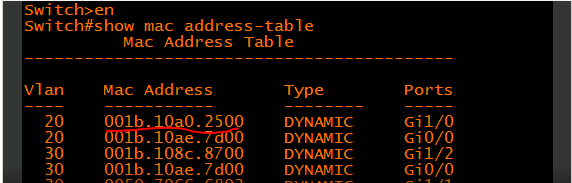

Hi @omatsu
 There is, but not so simple. You need to know which mac address your the device you are using have. With the mac address in hands, you can issue the command
show mac address-table mac <x.x.x.x>. This will show you which interface you are using.
 On the example below, suppose your mac address is 001b.10a0.2500, you would be on interface Gi1/0
