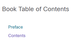

I digged into internet finding all possible guides to do reliable factory reset. I also searched for a way to do this via the push button. I wonder if all documents on the Cisco page for the Catalyst 100 series are complete, as the Software Configuration Guide, Cisco IOS Release 15.2(7)Ex (Catalyst1000 Switches) is only showing the contents page and nothing more. Is there any hint where to find that?

>>> Release 15.2(7)Ex (Catalyst1000 Switches) is only showing the contents page and nothing more <<<
you mean this page ?:
-> click on contents to open the contents
if this does not work, use another browser
RF-Emer
Thanks for the feedback concerning the Software Configuration Guide. I just oversaw that this is link based. I downloaded all the partial pieces of this document.
