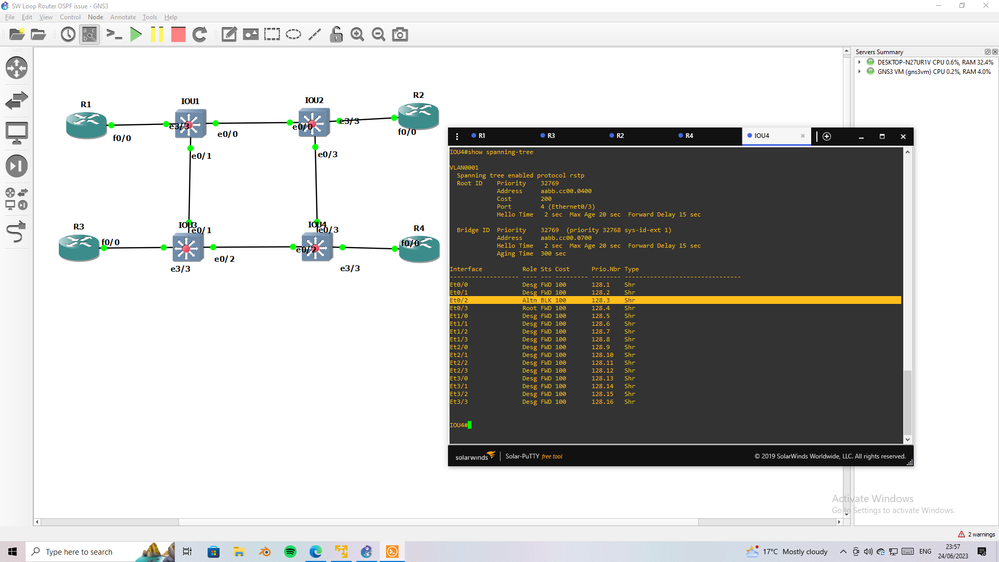

Can you also post the output of "sh spanning vlan 804" from both r2 and r4?
Site 4
MST0
Spanning tree enabled protocol mstp
Root ID Priority 4096
Address 40f0.78aa.9700
Cost 0
Port 410 (HundredGigE2/0/26)
Hello Time 2 sec Max Age 20 sec Forward Delay 15 sec
Bridge ID Priority 32768 (priority 32768 sys-id-ext 0)
Address 549f.c6bd.0e60
Interface Role Sts Cost Prio.Nbr Type
Twe1/0/3 Desg FWD 2000 128.195 P2p
Twe1/0/4 Desg FWD 2000 128.196 P2p
Twe1/0/5 Desg FWD 2000 128.197 P2p
Twe1/0/17 Desg FWD 2000 128.209 P2p
Twe1/0/21 Desg FWD 2000 128.213 P2p
Hu1/0/25 Altn BLK 500 128.217 P2p
Twe2/0/1 Desg FWD 2000 128.385 P2p
Twe2/0/2 Desg FWD 2000 128.386 P2p
Twe2/0/3 Desg FWD 2000 128.387 P2p
Twe2/0/17 Desg FWD 2000 128.401 P2p
Twe2/0/19 Desg FWD 20000 128.403 P2p
Twe2/0/21 Desg FWD 20000 128.405 P2p
Site 2
MST0
Cost 0
Port 218 (HundredGigE1/0/26)
Address 549f.c6bd.0dc0
Twe1/0/2 Desg FWD 20000 128.194 P2p
Twe1/0/8 Desg FWD 20000 128.200 P2p
Twe1/0/12 Desg FWD 2000 128.204 P2p
Hu2/0/26 Desg FWD 500 128.410 P2p
So, 1/0/25 is blocked and that is why there is no peering between 2 and 4.

Meanwhile I will try do some lab and check again all info. You share.
Have a nice day
MHM
Screenshot (837).pngScreenshot (838).pngScreenshot (839).pngScreenshot (840).pngScreenshot (841).png
