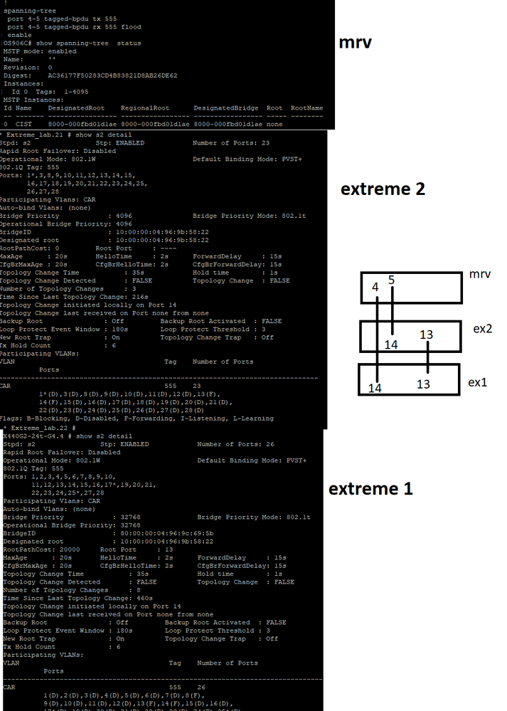

So in the lab, I've configured extremes to run PVST+, and on MRV just enabled MSTP without adding any VLAN to it, but configuring stp to forward and get the 555 bpdu. Now whenever i disconnect/connect the MRV, other switches notice a change in topology, but they don't do anything (probablu cuz they don't have to), but the problem is on the MRV site, he doesn't get any roots, he doesn't know who is the bridge,
etc
