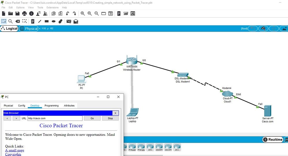

I am new to PT and taking the online intro course.
One of the designs they are using at the beginning has three computers connected to a WRT300N which connects to the internet via a cable modem the the cloud then to a server.
I cannot for the life of me get the WRT300n to receive an ip address in the internet port so I cannot ping or get DNS from a workstation to the remote server.
. What silly little thing am I missing?
Yes I am currently a complete noob with PT.
TIA - Mike

@wmtski666what PT version did you complete this on? I could not achieve it on v7.3.0 but using a DSL-modem with a 'phone' cable to the cloud device worked.I also could not reproduce the results following the instructions on 2.1.1.5.

Hi @luis_cordova
See attached.
Hi @CharltonOmondi0495
I have opened the exercise with version 7.3.0 and the connectivity objective is achieved.
Regards
Hi @luis_cordova
Sorry you may have missed my question.Yes that file works as is even for me in V7.3.0.However, it is not a 1 for 1 replication of what was outlined in the instructions for 2.1.1.5.My question was, why is the original instruction not working for me?What versions are the guys who managed to replicate it using?
perfect! that worked for me... thanks mate
Also if you choose the CORRECT WIRELESS ROUTER you will be abble to use the Straight-Through to connect to Cable Modem just as shown in the instruction.

Excuse me if i revive this old thread, but i solved this choosing the "WRT300N" Router from the list, in place of the "Home Router"; and i believe is that first device the one you are supposed to configure according to the 2.1.1.5 ex.'s guideline. In fact, during my first attempt, i could not understand where was the problem but i imagined it was with the connection between the router and the modem; i managed to accomplish the exercise with both routers, but still i can't explain why you have to use a copper cross-over wire with the Home Router (A) or a  Copper straight-through with the WRT300N(B)... ex.jpg
