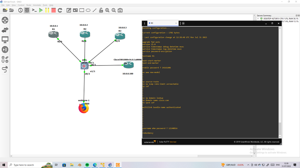

07-31-2023 02:41 AM - edited 07-31-2023 02:58 AM
service password-encryption command (this command for encrypt the any password which is clear text in show running )
In my lab I share enable and password of username before and after service password encryption
