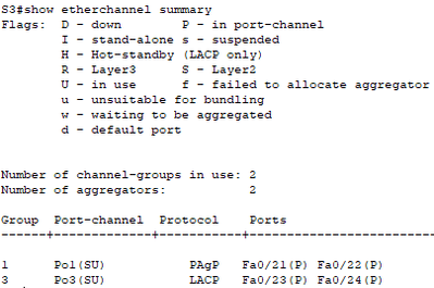

Hi, I am wondering why port-channel 3 works when I have 'access' at one end of Po3 and 'trunk' at the other end of Po3.
---Switch2---
interface Port-channel3
switchport mode access
interface FastEthernet0/23
channel-group 3 mode passive
interface FastEthernet0/24
---Switch3---
switchport mode trunk
channel-group 3 mode active
from this what i understand  is it might problem with packet tracer......it self...
As we know clearly...we can establish port-channel between similar links...Both sides either Access/Trunk...
When we use dissimilar modes port-channel shouldn't  be up/establish...
I think it is the limitation/bug  in packet tracer...
Thanks
8 Replies 8
Show interface status or show interface switchport check last mode of PO I think it access not trunk.
after executing the 'show interfaces status' command on the switch where I had previously set Po3 as 'switchport mode access' the only thing that changes is in the 'vlan' column from 'trunk' to '1', status, duplex, speed, type remain the same. So yes you are right, it is 'access' and not 'trunk' but I did it on purpose with the idea that it would fail, but however the port-channel works and it started me thinking.
How you test PO?
Joseph W. Doherty
"Hi, I am wondering why port-channel 3 works when I have 'access' at one end of Po3 and 'trunk' at the other end of Po3."
I would think for the same reason a non-Etherchannel access<>trunk would "work".  (It appears many believe cannot mix those port types, but, in the past, I've posted examples were it does "work", although with "issues".  My prior posts were not a recommendation to do this, but as teaching examples to better understand these port "kinds".)
Blue_Bird
if you are doing with Cisco Packet tracer.....save the topology....close the program..
reopen the topology and check....port-channel is up/down...?
It may helpful....
After re-open the CPT, Po3 us ip.
Thanks
I agree that most likely this is an issue with the emulator. But there is one possibility to consider: on the trunk the native vlan frames are forwarded without any tag. If that frame in the native vlan is received on the access port of the other switch it would be forwarded normally and "it works". However any frames in the other vlans on the trunk would not work. So "it works" would be only partially true.
HTH
Rick
