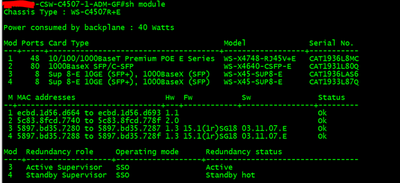

Leo Laohoo
What is the Supervisor Engine used?
What is the current IOS version?  What version is the intended upgrade meant to land on?
Hi @Leo Laohoo
current IOS version: cat4500es8-universal.SPA.03.03.02.XO.151-1.XO2.bin
new IOS version for upgrade: cat4500es8-universal.SPA.03.06.04.E.152-2.E4.bin
This is the detail of the switch and its supervisor
regards
Electronic20
Any specific reason for planning to upgrade old release.
cat4500es8-universal.SPA.03.06.04.E.152-2.E4.bin is very old release (2016), and firmware 15.1(1r)SG5 (2014)
It is recommended, you go for new release.
Here is upgrade procedure from cat4500es8-universal.SPA.03.03.02.XO.151-1.XO2.bin to cat4500es8-universal.SPA.03.11.07.E.152-7.E7.bin and firmware upgrade from 15.1(1r)SG5 to 15.1(1r)SG18 upgrade.
firmware filename :    firmwareupgrade-151_1r_SG18.SPA
New IOS file name :  cat4500es8-universal.SPA.03.11.07.E.152-7.E7.bin
just giving example for cat4500es8-universal.SPA.03.11.07.E.152-7.E7.bin, you can use recommended IOS as per your suitable environment.
you can upgrade new software by changing the boot variable for IOS and firmware in single reload at same time.
Copy new IOS and new  firmware (firmwareupgrade-151_1r_SG18.SPA) in bootflash and slavebootflash
Check the redundancy
Change the boot variable for new IOS and Firmware (ROMMON) save and reload.
Hope this will help
Regards
Shambhu Kumar
