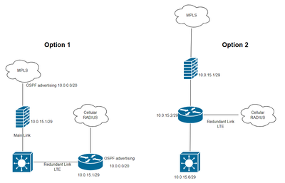

Is it possible to achieve a redundancy over different types of links that both advertise the same subnet over OSPF?
Would either of the configurations above work?   Either the router and firewall are connected to the switch or the firewall is connected to the router so it can alternate between MPLS or LTE as required.
If none of these would work - what is the best practice to create a working solution here?
