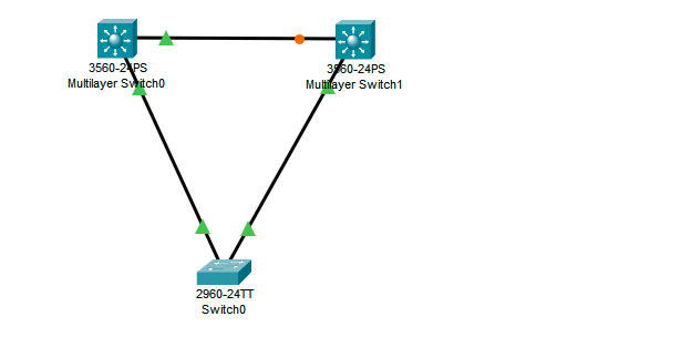

Are you saying that you have below scenario, where the 2960 in your case is a 9200 and the 3560 is 9500. The 9500 is in stackwise virtual but the 9200 even though connected with two interface to the 9500 have both interface in forward?
If you run the command
spanning-tree vlanX  root primary on the 9500  it will be the root for Vlan 6 and the interface to be blocked must be on the 9200
You have nailed the scenario. How is this even possible?
