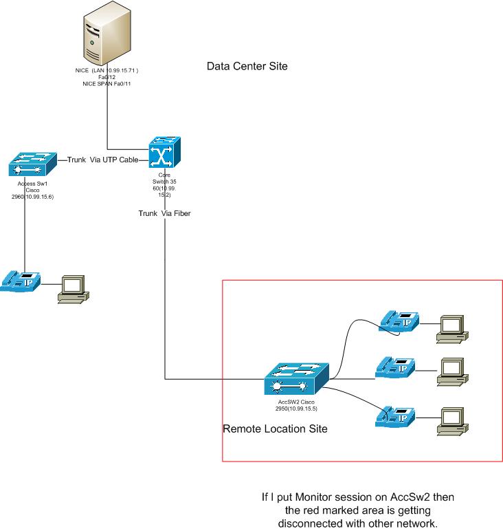

would be great if you provide your network topology too. how are the devices connected together?
Hi Marko
My  network Topology is attached here.
hello sultan!
it looks not to complicated. from this i would say i cant see any problems. maybe the traffic that the monitored switchports produce is too high. can u look for drops and errors on the trunk ports? and do you still have the problem if you only monitor one source port?
