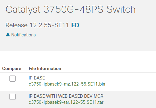

My switch is not networked and connected to my PC via console cable - does it need to be networked to download my firmware file from tftp(my computer)?
I've tried different methods to access my tftp server with no luck.
#archive download-sw /overwrite tftp://10.12.3.105/c3750-ipbasek9-tar.122-55.SE11.tar
Keep getting -
ADC-Visitor#$de /reload tftp://10.12.3.105/c3750-ipbasek9-tar.122-55.SE11.tar
Could not buffer tarfile...using multiple downloads
examining image...
%Error opening tftp://10.12.3.105/c3750-ipbasek9-tar.122-55.SE11.tar (Timed out)
%Error opening flash:update/info (No such file or directory)
ERROR: Image is not a valid IOS image archive.
I believe I am downloading the correct firmware upgrade -
Switch should able to reach the TFTP Server ( or you can setup TFTP Server on your Laptop, connect one of the Switch port to laptop configure with same IP address as Swtich SVI - Follow the below guide)
