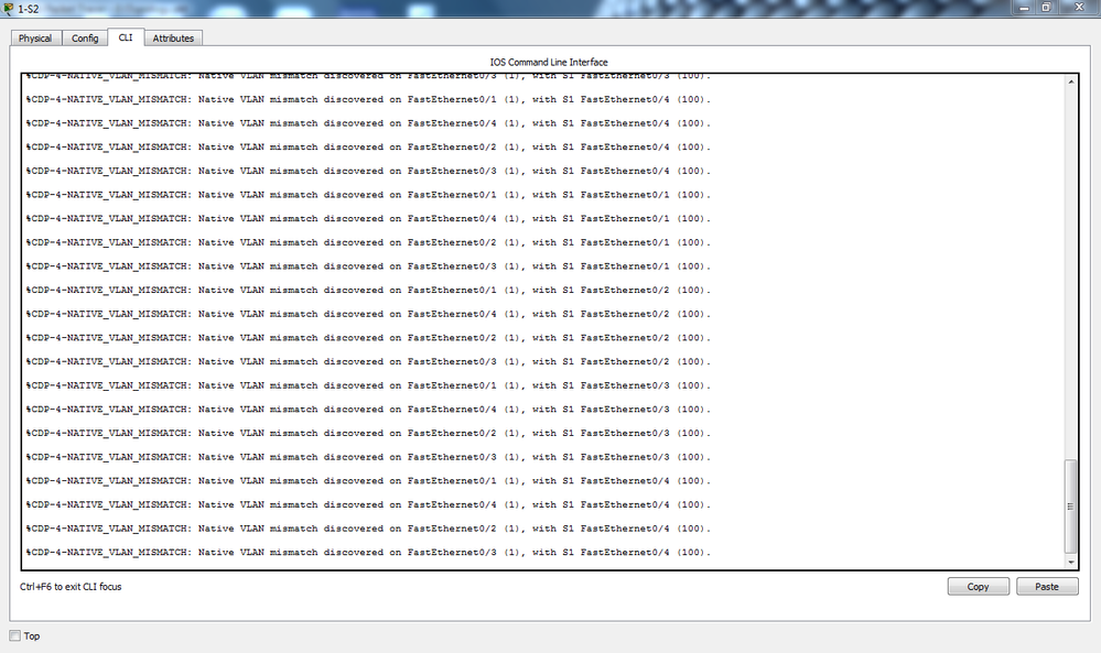

Hello. So for a lab I am doing with packet tracer, I am having an issue with ether channel. I have setup the etherchannel, and am able to ping through from pc through the etherchannel to another pc, but I am getting a vlan mismatch error. Pictures:112.PNG111.PNG

What is the configuration of the etherchannel interface? (show run int po1) This will need to be assigned as an access port in vlan 100.
Also, be careful. You have assigned vlan 100 to the interface IF it is an access port but haven't actually assigned it as an access port (switchport mode access). If DTP, which is enabled by default, negotiates the link as a trunk, the vlan assignment might not have any impact.

I switchported them.
It works! No errors! Thanks!! 🙂
