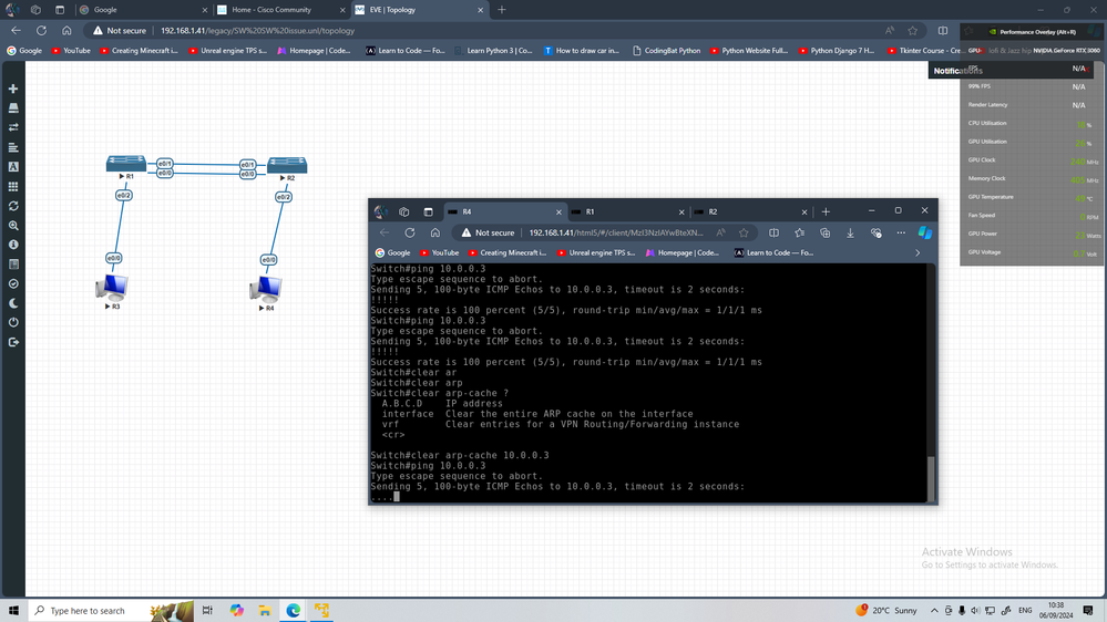

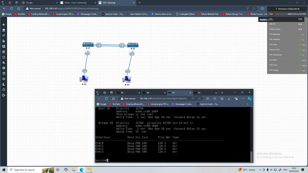

this simple topology R1 connect to R2 SW via two link
before I run bpdufilter in R1
there is reachability and check the input count in interface 3 or little more
after I run bpdufilter WITH Wrong design see what happened
NO reachability and Input count jump to thousand 20716 !!!!
this only two host connect to SW image more than 100 host sure the link see high rate traffic
this my last comment here because I will be busy for other issue
remove one PO
and then use MST in both SW
DONT WASTE YOUR TIME
