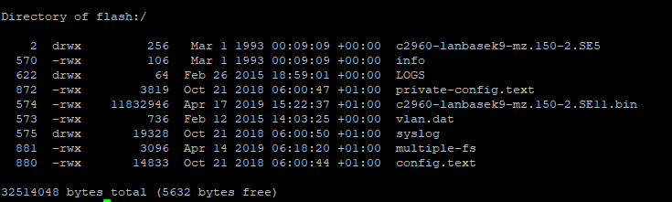

I need to upgrade an old switch.  I've copied over the newer firmware via tftp, but I see the original is a directory and not a bin file.  Can I simple add boot system flash:/c2960-lanbasek9-mz.150-2.SE11.bin and reload and it should take the newer one?

just do this below , save it check boot and then reload , just tested on spare 2960
(config)#boot system flash:c2960-lanbasek9-mz.150-2.SE11.bin
(config)#do wr

@Mark Malone is right.
You can either get the firmware package as a "tar" file which you extract.  It creates that subdirectory you can see with the web interface, and it updates the boot environment.
You can read about the process here (jump down to "Extracting a tar File"):
https://www.cisco.com/c/en/us/td/docs/switches/lan/catalyst2960/software/release/12-2_58_se/configuration/guide/2960scg/swiosfs.html#86987
Or you can just copy the boot file and update the boot environment yourself.
Thanks that worked.
Just doing another switch and it's flash has lots config files, I guess because of crashes, but I'm not sure.  See photo.
Also the firmware seems to be an EX3 file what is this?
