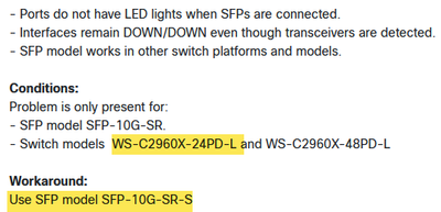

 - @JJBGage     Just found : https://bst.cisco.com/bugsearch/bug/CSCwh07400?rfs=qvred

Well, did you read the bug report mentioned by @marce1000 above? It explains exactly what is happening!
In case you have no access to the bug report tool, here are the important parts:
Cisco considers this to be a "Minor" bug, meaning there are no plans to fix it.
So you need to use a different type of SFP for this specific 2960x model only, while other models should work just fine.
HTH!
OK, yes I saw the bug report.  Did you see my request for a SFP that will work?  Please name a specific SFP model that will work with the 2960 so I can buy it.
Thank you again.
Hmmm... I even marked the workaround in yellow in my post...
Use SFP model SFP-10G-SR-S
