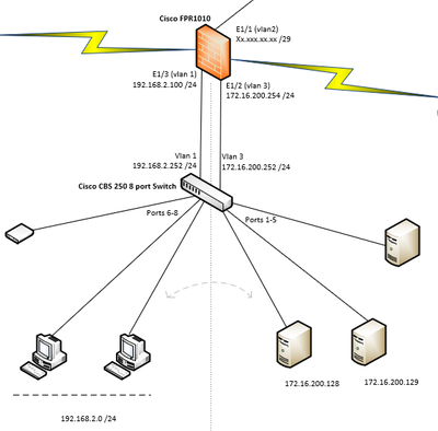

Can anyone help me / point me in the right direction with setting up ACLs on the CBS 250 switch.
Im so used to doing it on normal switches using the CLI but on this device its just web based and nothing I try that i think makes sense works.   I have lost all access to it several times as I bind ACLs to vlans as well.   I feel like i am just going round in circles getting nowhere.
All I want to do is allow ping and ports 1000 and 69 between my two vlans.  (but also i am guessing i need to allow 443 to be able to get on to manage the switch and for internet access for vlan 3?)
Vlan 1 - 192.168.2.0
Vlan 3 - 172.16.200.0
The network is setup like below (I would have preferred a trunk to the firewall but I am not allowed to change that at the moment).
The CBS switch has ipv4 routing enabled.

balaji.bandi
CBS is small business switches, i would avoide make more complicated for the device functionalioty like more ACL inspection
If the device have Gateway configure FW IP, then do the all the restriction on Firewall as per the configuration.
Or is the end device gateway is CBS Switch ?
BB
Customer has said the ACLs must be on the switch as this is how it was previously set up.   If it was me doing my own setup I would have all security done on the firewall.
For additional info the end devices gateways are the firewall but they set static routes on the end devices to point to the other vlan.

peat
Sorry ive just realised the laptop in the LAN was going out to the firewall as when I pulled that connection, everything stopped working. so back to square one
The ACL need to tag to Layer 3 Interface check this video :
https://www.youtube.com/watch?v=08T4Ovw7O48
If the end device Gateway are Firewall, then the ACL need to be created on Firewall as i mentioned before.
If the end device point to Gateway to switch IP only this take effective.
I have deleted all acls and aces now and still cant ping between the 2 vlans.  They are both classed as directly connected arent they? so there shouldnt be any reason why I cant ping between them.  Unless I am missing something?
If the CBS doing inter-vlan routing and device point to switch all should work expecte between these 2 VLAN, but as you mentioned all device point to Firewall, firewall doing routing and protection between the VLAN. in the Case Switch acting just layer 2
what interface connected on switch to Firewall - the diagram show only Firewall side not on the switch side.
BB
Thanks.  Yes thats the video i originally looked at.
I have just tested it and I can deny a ping between the two vlans with the ACL on the switch with the Gateways set on the firewall.
(For info there are ACLs on the firewall that match the ACLs on the switch.  Ie allow the same ports and ping)
I have static routes set on the two end devices telling it to use the switch l3 gw to reach the other vlan.
(I know this is a bad way to do it but ive got my hands tied and have to do it as the customer has other sites working this way.)
switch port 5 ------> port 2 firewall  (vlan 3)
switch port 6 ------> port 3 firewall  (vlan 1)
Sure if that is your rquirement you can do that and let us know if you have still issue to help.
BB
All sorted now.  Well I can get traffic being allowed one way through the switch which will do for now.
Basically the change that made it work was to not have the same port number as source and destination.  Once i changed it to one ace had any 69 and the other 69 any.  The traffic would work.
