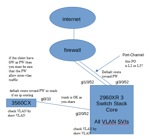

can you draw the topology
I am no artist, so I hope this helps.
