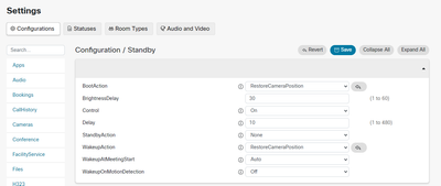

How have you configured the Standby Setting on the endpoint?   You may find that it's better to have them set to RestoreCameraPosition rather than default.

Wondering if this will fix the problem we are having with a Room Kit Pro (in MTR Mode) with a QuadCam.
Whenever the system goes to sleep or reboots, it defaults back to "Manual" in the camera settings.  We keep the room on "Speaker" and would expect it stays on that all the time (unless someone changed it during a meeting), but then would want it to always go back to "Speaker" when waking up or rebooting.
I tried changing both of these settings.  Will update in the morning when I visit the room.
The StandByAction is also a bit pointless on the QuadCam (unlike the P60 or SpeakerTrack60 cameras), but it may also be worth setting that to "None" as well, to make sure when the unit goes in to Standby mode, that camera settings are also not changed then either.

Setting both to "RestoreCameraPosition" did technically solve the issue.  The room has stayed on "Speaker" now vs reverting back to Manual post sleep/reboot.
I'll probably test setting both to None.  In theory, its the same thing as the device should stay on "Speaker" if nobody changes it.   I do find it weird there is an option for "DefaultCameraPosition" when there is no clear setting to choose the camera mode for things to default back to.
Welp today they came in and the Camera mode was set back to Manual again.   I'm attempting to change both settings today to "None" and see if that resolves things.   If not, I suppose it's TAC case time.   It's a shame there isn't a clear simple setting for this as one would think there would be.
