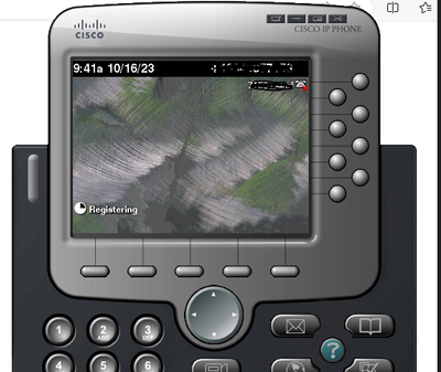

I am unable to register Cisco IP Communicator. The device shows registering all the time. I know we need to look at EventView logs from CUCM. But when I download the logs it shows nothing. I am using TranslatorX to read the logs. Any other troubleshooting can help to resolve this issue? Its a CUCM 11.5 cluster. Please advice

It says keep registering and there is a red color X symbol on the top of DN. Attached screenshot . I do not find any logs on the Eventviewer and syslog. Please help me to resolve the issue

The above two messages are there in the status messages. The CIPC able to get the cnf file from TFTP server. The only problem is the CIPC display keep says registering and the DN shows red X on the phone icon.

Suggestion 1 -> I could not do because I do not see the IP address for the CIPC in CUCM.
Suggestion 2 -> I followed this. After delete both Communicator folder I re-launched CIPC. First time the application is crashed. I re-launched again. It shows updating locale. Then the display shows the same as registering and Red X sybmol on the DN.
