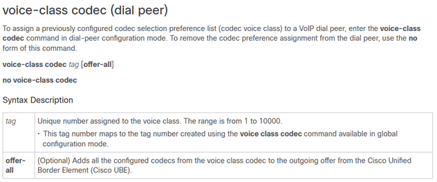

Does anybody know what's the point of "offer-all" at the end of the "voice-class codec" command?
Doesn't CUBE sends all codecs from the "voice class codec" even if we do not configure this "offer-all" or maybe I miss something?

I think, the important part is "outgoing offer" in the description.
My opinion:
If CUBE sends out an INVITE as early-offer and delayed-offer, then all the codecs from the list are in the SDP. Doesn't matter if the parameter is set, because CUBE is the one, that initiates the SDP exchange.
If CUBE receives an INVITE with SDP, then normally, CUBE would only respond with the codecs, that overlap with the codecs in the received SDP and it's configured codec list.
--> If the parameter "offer-all" is set, then CUBE would respond with all codecs in the codec list.

Hey Tomc101010
There is a detailed explained on book 'Understanding session border controllers" page 405
In a nutshell CUBE (by default and without command offer all)  uses codec filtering when sending outbound invite. "Offer all" change this.
Without "offer all" on outbound voice class
Inbound Invite  (SDP G711ulaw, Opus, G729)
Inbound Dial Peer (G711ulaw, G711alaw, Opus)
Outbound Dial Peer (Opus, iLbc)
Outbound Invite (SDP Opus)
Step 1: Invites comes in with (SDP G711ulaw, Opus, G729) and matches Inbound Dial Peer (G711ulaw, G711alaw, Opus) --> G729 is filter out by inbound voice class
Step 2: Outbound Invite (before filtering) has G711ulaw and Opus and matches Outbound Dial Peer (Opus) --> G711ulaw is filtered out by outbound voice class.
Step 3: Outbound invite is send with Opus
With "offer all" on outbound voice class
Outbound Dial Peer (Opus, ilbc)
Outbound Invite (SDP Opus,ilbc)
Step 1: Invites comes in with (SDP G711ulaw, Opus,G729) and matches Inbound Dial Peer (G711ulaw, G711alaw, Opus) --> G729 is filter out by inbound voice class
Step 2: Outbound Invite has G711ulaw and Opus and matches Outbound Dial Peer (Opus,ilbc) --> No filtered
Step 3: Outbound invite is send with Opus and ilbc
It is possible that negocciation with remote end  eventually selects ilbc, that's why local transcoding (LTI) is recommended on CUBE when removing default filtering mechanism.
