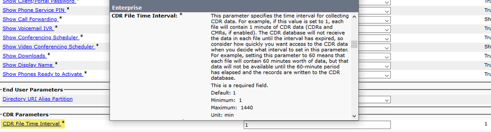

What value did you try to alter for this? Based on the help readme this would be what you'd want to modify if you want a longer time period between the files sent to the billing server.
From Serviceability > Tools > CDR Management help page
From Enterprise parameters

That's an unrelated setting for this. You'd want to change the Enterprise parameter that I wrote about.
