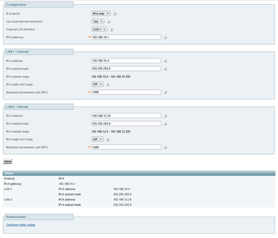

Would you be able to share a screenshot of the IP configuration and the static route(s)?
Response Signature
Here's the current setup. 192.168.12.0/24 is the internal subnet where the UC apps and client PCs are located. 192.168.15.0/24 is the external subnet to emulate internet connectivity for the purposes of MRA.
FireShot Pro Webpage Screenshot #002 - 'hq-exp-e2 - Static routes' - https.png
