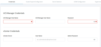

Hi Steven,
I'm trying to read the article and found below steps:
It mentions there will be an automatic association but how? I have the HXDP installer OVA deployed and may I know how should I achieve this? If I click on the standard workflow for cluster expansion, it won't allow me to select Compute-Only node. I've to click on the "I know what I'm doing" for adding compute-only node. But from there, if I tick ESXi configuration & Deploy HX Software, it won't allow me to select the compute-only node. So after I deployed the HXDP installer, what is the next action like which should I click into for having the service profile automatic association as I'm a bit confuse in this.
My current compute-only nodes have no ESXi installed and I have a lot of compute-only nodes and each of them need to be added to three different HX cluster.

What step is your install failing?
Hi Steven,
I failed on the first step which is after selecting compute-only nodes from the standard cluster expansion workflow. My compute-only node is UCS C220 M5SX and with two local disks. Why would this error appear?
Morning Markus,
it looks like it is taking the new server as a converged node instead of a compute-only node, that's the kind of error I've seen before, since Disk type is irrelevant for a compute-only node.
trying to find some relevant info to compare to.

quick question (maybe irrelevant), is your current browser in a different language than english? there's a defect in which workflow will complain about browser language CSCwe45153
