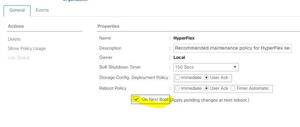

So most 'reset/reboot' type actions taken by the UCSM needing to power cycle a blade/rack server involve acpi commands sent to the server OS, and then after a period (i think 120 seconds) if the UCSM doesn't detect any movement by the OS, it will do hard power reset.
There is an option in the user ACK/Maintenance Policies pending reboot.JPG
for 'pending next reboot', which means the actual ucsm tasks, won't actually trigger the power cycle, but will wait for you to do the actually reboot via the OS.
Sounds like if the UCSM is having a hard time getting the OS to gracefully reboot, that the 'on next boot' option is your best option for a graceful acknowledgement.
Kirk...

It's probably more scalable to get comfortable with the 'on next reboot' methodology, as you can line up/apply multiple servers sharing the same host firmware policy, and then just reboot individually  from the  OS.
