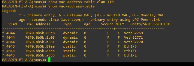

If you haven't created vlan subinterfaces for tagging vlan traffic (https://wiki.ubuntu.com/vlan) , then you will want to make sure you mark the LAN at the service profile level (vnic, lan) as native to see if this is working correctly.
Also, see if you are learning any mac addresses at the FI level (connect nxos, show mac address-table vlan xx) ?
What does ethtool eth0,  ethtool -S eth0, or ethtool -i eth0 show?
Kirk...

That's an out of the box Ubuntu 18.04.5 install (note drivers in the download only go to 18.04.4). I ran the cmd on a configured interface. And can you lead me through how I get  " then you will want to make sure you mark the LAN at the service profile level (vnic, lan) as native to see if this is working correctly."? Not sure where I should be looking.
