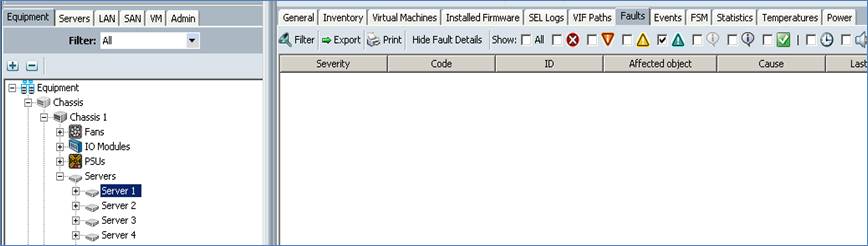

Here's my persistent fault (Severity=Warning) in Fault Summary:
Here's what I get when I click on the green triangle icon in the Fault Summary:
I get nothing.  So I can't address the fault.
It shows up under the associated Service Profile as well.  I have tried dis-associating/re-associating the profile.  I have tried Recover Server.  The situation is the same even when another user on another PC checks it from his UCS Manager.  The same problem exists on 7 other blades of the same model.  All blades are new B200-M3.  Please let me know how I can address the underlying issue (if any).  Or if not; how can I remove this fault.

Hello David,
Looks like system is running into known issue
CSCud94255 which is duped to CSCud79598
http://tools.cisco.com/Support/BugToolKit/search/getBugDetails.do?method=fetchBugDetails&bugId=CSCud79598
As a work around, please try the following
SSH into FI
connect local-mgmt
cluster lead b     ( where FI B is acting secondary )
HTH
Padma

David Duwe
My system did run into the known issue as you suspected.  The workaround reset the Fault Summary to all zeros and cleared up the problem.  After I changed the cluster lead to Fabric Interconnect-B, I flipped it it back to A and the faults were still all zeros.  Thank you very much for your help!
