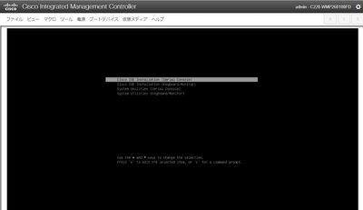

As a title, I re-installed Cisco ISE with CIMC based on Installation Guide below, but some problem occured.
●Install Cisco ISE (Cisco Identity Services Engine Installation Guide, Release 3.0)
https://www.cisco.com/c/en/us/td/docs/security/ise/3-0/install_guide/b_ise_InstallationGuide30/b_ise_InstallationGuide30_chapter_3.html
Specifically, after selecting [Cisco ISE Installation (Serial Console), this screen was displayed. I don`t know this message means and how to solve this problem. Because of this problem, I can`t proceed to Step 4.
Thank you.

Have you tried the 'keyboard' method?  Just curious if it drops you to same UEFI boot menu.
You land at the UEFI boot menu when configured boot entries are not bootable.  Wondering if you are having issues with your vKVM mount of the ISO, etc...

Hi Kirk J.
Thank you for your reply.
As you mentioned, I tryied the 'keyboard' method as well, but result was the same.
IOS image I mounted is this.
[ise-2.7.0.356.SPA.x86_64.iso]
Do you thik this IOS image is correct when installing ISE on Cisco UCS ?
