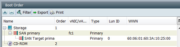

I've been trying to get our UCS to boot from our CX4 in a test environment. Our CX4 is directly connected to our dual 6120 FIs. I believe our SAN is correctly configured for basic access as I have been able to see it and load ESXi 5.0 onto a LUN I have presented to it. I am, however, unable to get the server to boot from the NOS partition.
On the UCS side I have created a Boot order Policy with WWN of the LUN I'm presenting:

Let us first confirm that there are no typos in target WWPN and it is pointing to correct LUN.
Then, on the Blade > General > Boot Order Details tab, does Configured boot order match with Actual order information ?
What is the vHBA name defined in boot policy and  vHBA name in the service profile ?

I believe there are no typos in the WWPN although I was a little confused on what to enter in the Boot Policy. The column in the Boot Policy says "WWN" however when you enter it, the entry says, "WWPN".
If you look at the 2nd graphic with the heading "Disk Details" that I posted you will see the "Full Disk Name". The WWPN I entered in the Boot Policy is WWN after "naa": 60:06:01:60:3A:10:25:00. It is the same in the Boot Order graphic I posted.Looking at the LUN information on my SAN, I see this:
Did I enter the correct information for the WWN in the Boot Policy?
In the Boot Policy, the Storage with SAN Primary is Order 1 and the CD is Order 2.

On the Blade > General > Boot Order Details tab, does Configured boot order match with Actual order information ?

On the Blade > Boot Order tab, I see SAN primary as Order 1 and CD-ROM as Order 2. I don't know if that's the actual order.
I do, however, see under Blade > Storage I see:
fc0, Desired Order =1, Actual Order =5
fc1, Desired Order = 2, Actual Order =6
The vHBA name defined in the boot policy is "fc0". It is the same as the one under the storage tab, "fc0"

1)  Under Equipment >  Chassis > Servers >  Blade # >  General > Boot Order Details
Do we observe the LUNs under Configured & Actual Boot order tabs ?
2)  In the screen shot provided in your first post, I notice ( fc1 -- vHBA name ) as Primary HBA device in boot order policy.
Does this match with your first vHBA device name ( fc1 ) created under service profile ?

I was able to fix this problem on my own, but that you for the troubleshooting steps. My problem was the target WWN int eh Boot Order Policy was incorrect. I was using the WWPN of the LUN I was trying to boot from. Instead I should have been using the WWPN of the EMC Storage Processor Port.
