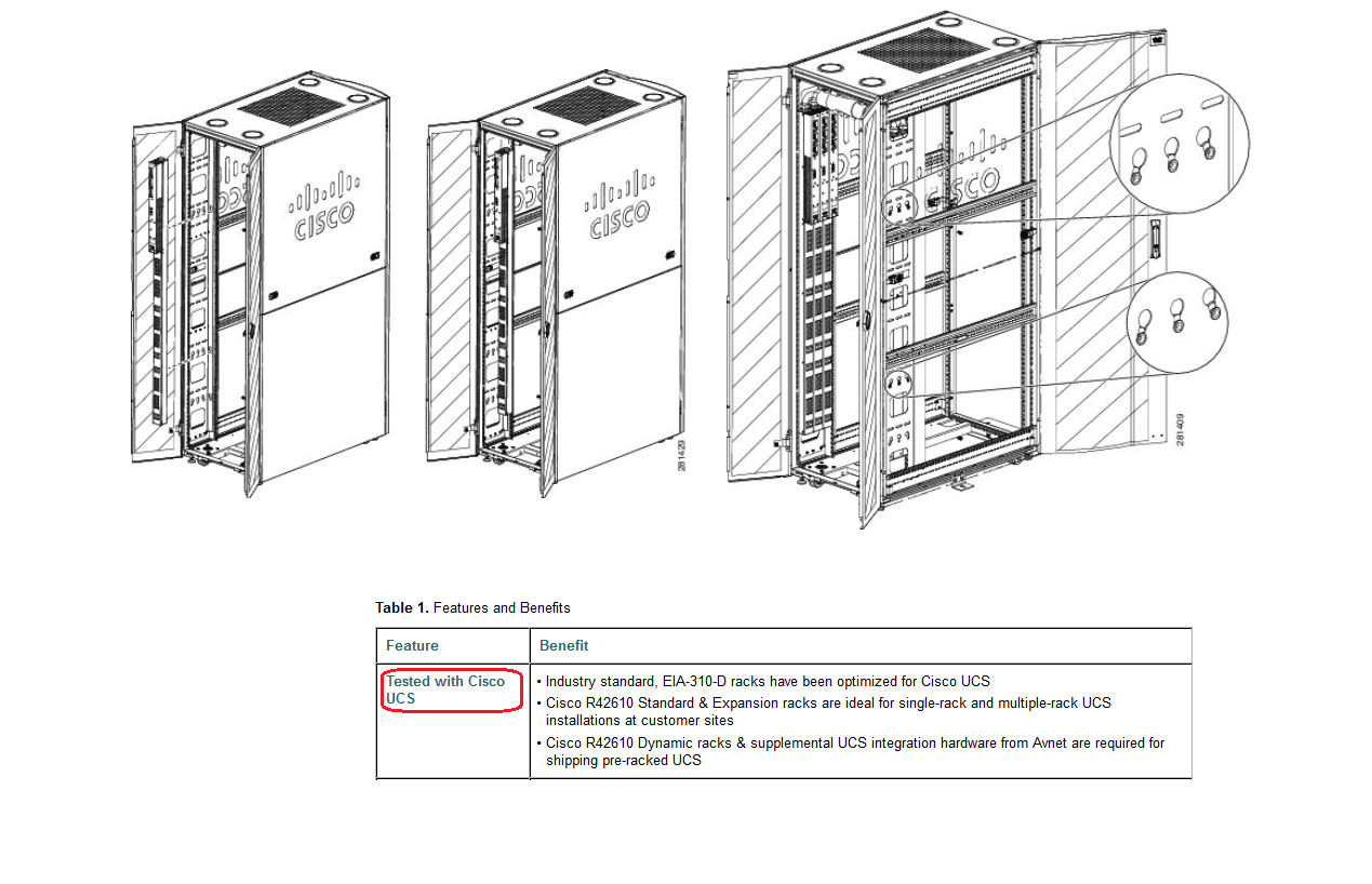

Reuben,
We definitely have sensors all over the C220 that will regulate the temperature/fan speed.
The Fan Speed policy will be "ignored" if the server requires higher fan speed to cool down.  This is expected behavior as it is obvious that it is better to ignore the configured policy in case the server is getting hot. The server itself does not have to be boiling on the surface to increment the fan speed; as long as any of the sensors in the server detects a high temperature, the fan speed will be incremented until that sensors lowers the alarm/temperature.
In regards to the rack itself, have you seen our R-Series?
http://www.cisco.com/en/US/products/ps11518/index.html
http://www.cisco.com/en/US/docs/unified_computing/ucs/hw/rack_power/installation/guide/power.html
