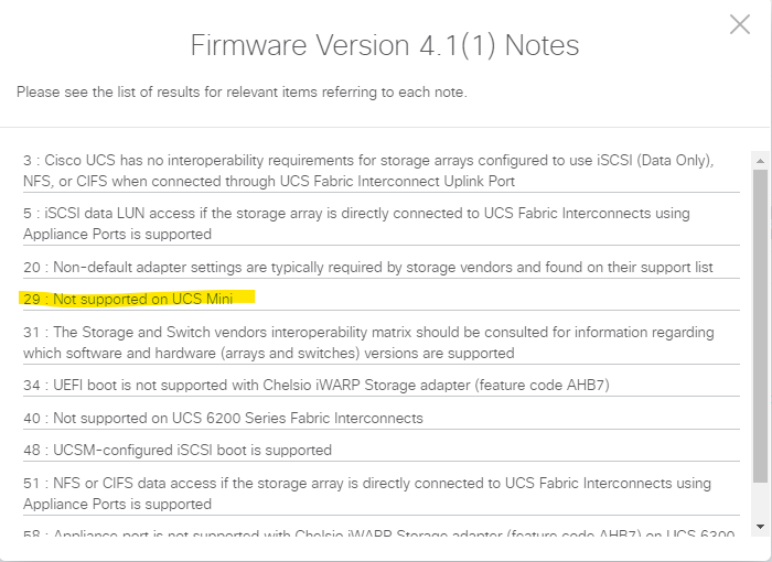

I have a UCS MINI domain with v4.0(4b) firmware, ESXi v6.7u1 and using FC via Brocade switches for SAN access.
Now I have purchased new MDS switches and IBM Storwiz FS7200 to replace the existing SAN infrastructure. It should be a fairly straight forward process IMHO but the confusion comes in when I checked UCS Compatibility matrix, link below.
https://ucshcltool.cloudapps.cisco.com/public/
It shows the IBM 7200 is only supported with UCS Firmware v4.1 and above. It also shows "Not supported on UCS Mini" in the notes, screenshot below. So the questions:
  1. Is the firmware v4.1 required when IBM 7200 is connected via MDS switches?
  2. Does this "Not supported on UCS Mini" only apply to when the storage is directly attached using FC OR it applies to both directly attached and connected via MDS switch?
I did also open a TAC case regards, but the answer I got from TAC is mixed...
