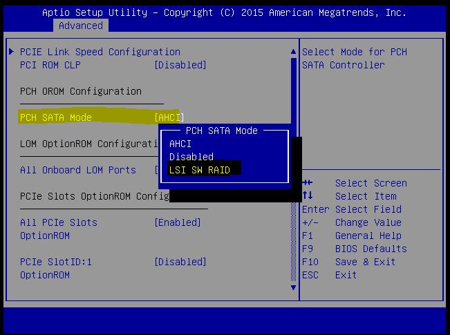

esethu
Hi Kirk,
Tried  to disable  Embedded RAID Controller in the BIOS  but unable to see the south bridge option in Advanced Tab.
Kirk J
After this, you will see the option to hit CNtrL + M for MegaraidSR during post, and can configure your Raid5, assuming the 'Key' is installed on the systemboard correctly.
