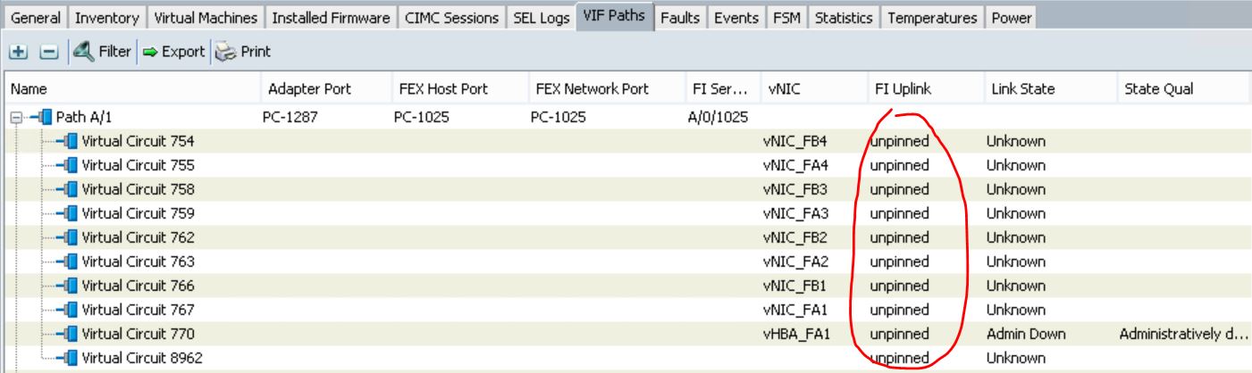

I need your suggestions. I just apply 2 profiles to 2 blades. 1 Blade came up fine. The other one came up with this. All Virtual Circuits are unpinned.  I don't have any Pin group setup.
Yes, I have tried to turn it off and on :)), same issue
I have 4 connections from each FEX to FA and FB
Please advise!
2 Replies 2
Khoa Pham
Found the fix. Actually it fixed itself when the OS loaded the drivers :))
Hi Khoa,
I am glad you were able to figured this out, also note that this is an expected behavior so if you ever power down your blade you may see this same faults in UCSM, but once you power the server back on the faults will clear.
