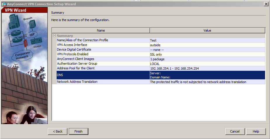

i have two ASA 5505 and the Anyconnect VPN Wizard does not work properly. I have used it on several other 5505s before and it worked fine but now i have two ASA 5505s where i can start the wizard, make my configurations and when im on the last page i cannot click "finish". It just doesnt do anything, no error message, it just wont let me click the button (or Alt+F). I tried it via ASDM from a Win 7, Win 8 and a Win Server 2012 and i tried the Java Web Start Application - same problem.
So it has to be some problem with the ASA but since two ASAs are affected i have no idea what might be causing this. The versions are ASA 9.0(1) and ASDM 7.1(1)52
Any ideas or any way to check what could cause this? I tried to reset them to factory default but the wizard still wont let me do the configuration...

So you are getting to this point and the Finish button is greyed out?
May I know the Java version?
Have you tried with ASDM 7.1.5.100?

my Java version is 7 Update 51 so the newest version, but my Finish Button is not greyed out, it just doesnt do anything when i click (or Alt+F or select with tab and enter). Here is a screenshot:test.JPG
But i made some tests yesterday and i think it might be caused by the config, if i configure a static IP for the outside interface the wizard works. If i choose PPPoE and PAT the wizard wont let me finish. However i have to use PPPoE and PAT
And i have set up a VPN with PPPoE with older versions (ASA 8 and a 6er version of ASDM) which worked just fine. But with ASA 9.0(1) and ASDM 7.1(1)52 i can reproduce if i choose PPPoE and obtain IP via PPPoE and PAT then the Anyconnect Wizard does not let me finish.
Are you aware of any changes that might cause this? It`s strange that i do not see any kind of error message.

Would you mind upgrading the ASDM to the latest release?
It would help us isolate the issue.
