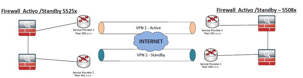

Hi Experts
I have this scenario, we currently have a VPN Site to Site with some ASA 5508x already active with my Service Provider 1 and I want to configure the contingency with another Peer (New Public IP) with my Service Provider 2,
There is some additional configuration that you have to put in the ASA.
I have only declared the following statement adding the 2nd public ip from the other end of the ASA, here the configuration:
crypto map outside_map 1 match address outside_cryptomap_3
crypto map outside_map 1 set pfs group5
crypto map outside_map 1 set peer 201.x.x.x 190.x.x.x
crypto map outside_map 1 set ikev1 transform-set ESP-AES-128-SHA
crypto map outside_map 1 set ikev2 pre-shared-key *****
crypto map outside_map 1 set security-association lifetime seconds 28800
crypto map outside_map 1 set df-bit set-df
Our test will be to disconnect the internet from 1 end and see if it commutes with the other internet 2 link or is there something that I need to configure in the ASA?
Thank you in advance for your help if you have faced a simulated scenario
