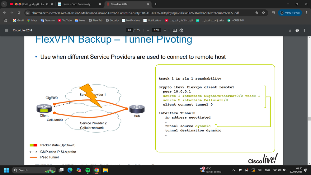

are you sure you use correct source in ip sla of track, as I see you dont use source in SLA
MHM
