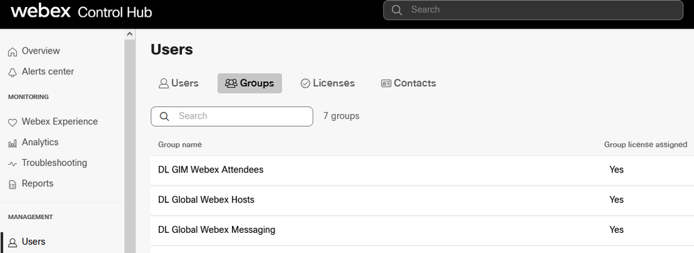

The use of the filter object in the Groups part of your screenshot is not intended to be used as you understand it. It's use is for filtering what group(s) to bring into Control Hub, not the actual member(s) of the group(s). The use of these group(s) are then to use them for controlling license assignment in Control Hub.
Here is an example of how we use this in our Control Hub.
