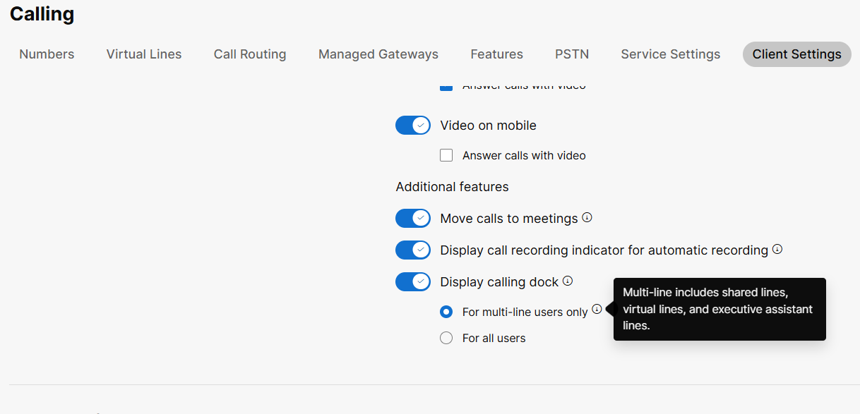

This doc shows that Call Queues can be shown in the Multicall Window - www.webex.com/content/dam/www/us/en/documents/pdf/reimagining-multiline-experience-aag.pdf
In Control Hub, the "i" shows Shared lines, Virtual lines, and Executive Assistant lines. Nothing about Call Queues.
