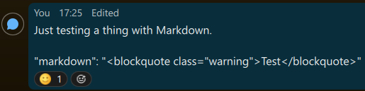

I might be daft but this does not work for me. Are you using that line exactly as you typed it in your response?
To me it results in this.
Response Signature
It will only work when posting messages via the /messages API and using the "markdown" field.
Aha, got it. Thanks.
Response Signature
Nope, he was using the API for creating messages: https://developer.webex.com/docs/api/v1/messages/create-a-message
That endpoint accepts a markdown parameter.
You may also try it from that page and just paste
<blockquote class="warning">Some text</blockquote>
into the markdown field
Amazing. Thank you!!!!!
