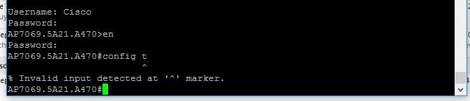

Someone here can help me with that? We have bought the new cisco AP2802i, because is the new model of AP2602i. As we now the AP2602i need be converted to Autonomous Mode to access the configuration global mode (configure terminal). Now in this new model we can't convert it, because the new Autonomous mode is the Mobility Express. But I can't access the configuration terminal, that I need to configure for our project. Someone here can help us? We tried everything, debug commands, change to LWAPP after back to Mobility Express.

I tried that command already, still the same. I don't have that option "console cli".
just copy and paste this command.
Above command is only for older APs (1600,1700,2600,2700...etc)
I tried copy and paste and return me that:

Notice the AP's name are all in CAPs?  This means the AP is 2800/3800.
This model, Ap2800/3800, do not support Autonomous IOS.
Autonomous IOS has been superseded by Cisco Mobility Express.
