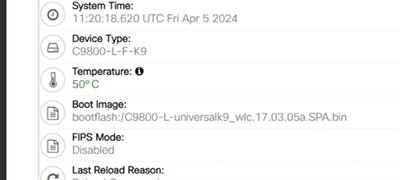

What version the WLC running
Potentially hit:
https://www.cisco.com/c/en/us/support/docs/field-notices/639/fn63942.html

Your 3702 ap's begin as AIROS devices.  They are supported in the 9800 in 17.3.x and older.  they were removed in 17.4 and returned in 17.9.3.  All wave1 AP's are then removed in all newer code trains.
x702 aps also have expired certs Dec2021.  causing one to need to reset the 9800 date to a date earlier than Dec21 (or was it 22).  a current code image resolves that problem. If they are being rejected for certs, they most likely will not get recorded in the join log as a device knocking on the door.

*Apr 5 11:20:13.631: %SEC_LOGIN-5-WEBLOGIN_SUCCESS: Login Success [user: Towers] [Source: ] at 11:20:13 UTC Fri Apr 5 2024
*Apr 5 11:20:13.632: %WEBSERVER-5-LOGIN_PASSED: Chassis 1 R0/0: : Login Successful from host 172.20.0.254 by user 'Towers' using crypto cipher 'ECDHE-RSA-AES128-GCM-SHA256'
*Apr 5 11:42:13.722: %WEBSERVER-5-SESS_LOGOUT: Chassis 1 R0/0: : Successfully logged out from host 172.20.0.254 by user 'Towers' using crypto cipher 'ECDHE-RSA-AES128-GCM-SHA256'
*Apr 5 13:06:49.620: %SEC_LOGIN-5-WEBLOGIN_SUCCESS: Login Success [user: Towers] [Source: ] at 13:06:49 UTC Fri Apr 5 2024
*Apr 5 13:06:49.620: %WEBSERVER-5-LOGIN_PASSED: Chassis 1 R0/0: : Login Successful from host 172.20.0.254 by user 'Towers' using crypto cipher 'ECDHE-RSA-AES128-GCM-SHA256'
*Apr 5 13:27:02.087: %SYS-6-CLOCKUPDATE: System clock has been updated from 13:27:02 UTC Fri Apr 5 2024 to 13:27:02 GMT Fri Apr 5 2024, configured from console by Towers on vty0.
*Apr 5 02:30:00.000: %SYS-6-CLOCKUPDATE: System clock has been updated from 13:27:02 GMT Fri Apr 5 2024 to 02:30:00 GMT Fri Apr 5 2024, configured from console by Towers on vty0.
Apr 5 02:30:00.000: %PKI-6-AUTHORITATIVE_CLOCK: The system clock has been set.
Apr 5 02:30:00.012: %SYS-5-CONFIG_P: Configured programmatically by process SEP_webui_wsma_http from console as Towers on vty0
Apr 5 02:30:10.208: %WEBSERVER-5-SESS_LOGOUT: Chassis 1 R0/0: : Successfully logged out from host 172.20.0.254 by user 'Towers' using crypto cipher 'ECDHE-RSA-AES128-GCM-SHA256'
Apr 5 02:30:43.926: %SEC_LOGIN-5-WEBLOGIN_SUCCESS: Login Success [user: Towers] [Source: ] at 02:30:43 GMT Fri Apr 5 2024
Apr 5 02:30:43.926: %WEBSERVER-5-LOGIN_PASSED: Chassis 1 R0/0: : Login Successful from host 172.20.0.254 by user 'Towers' using crypto cipher 'ECDHE-RSA-AES128-GCM-SHA256'
Apr 5 02:37:55.841: %SEC_LOGIN-5-LOGIN_SUCCESS: Login Success [user: Towers] [Source: 172.20.0.254] [localport: 22] at 02:37:55 GMT Fri Apr 5 2024
Apr 5 02:39:21.442: %SYS-5-CONFIG_I: Configured from console by Towers on vty0 (172.20.0.254)
Apr 5 02:53:25.050: %WEBSERVER-5-SESS_LOGOUT: Chassis 1 R0/0: : Successfully logged out from host 172.20.0.254 by user 'Towers' using crypto cipher 'ECDHE-RSA-AES128-GCM-SHA256'
Apr 5 02:54:56.761: %SYS-6-TTY_EXPIRE_TIMER: (exec timer expired, tty 2 (172.20.0.254)), user Towers
Apr 5 02:54:56.761: %SYS-6-LOGOUT: User Towers has exited tty session 2(172.20.0.254)
Apr 5 04:45:33.153: %SMART_LIC-3-COMM_FAILED: Communications failure with the Cisco Smart License Utility (CSLU) : Unable to resolve server hostname/domain name
Apr 5 05:01:59.019: %SEC_LOGIN-5-LOGIN_SUCCESS: Login Success [user: Towers] [Source: 172.20.0.254] [localport: 22] at 05:01:59 GMT Fri Apr 5 2024
WLC#
