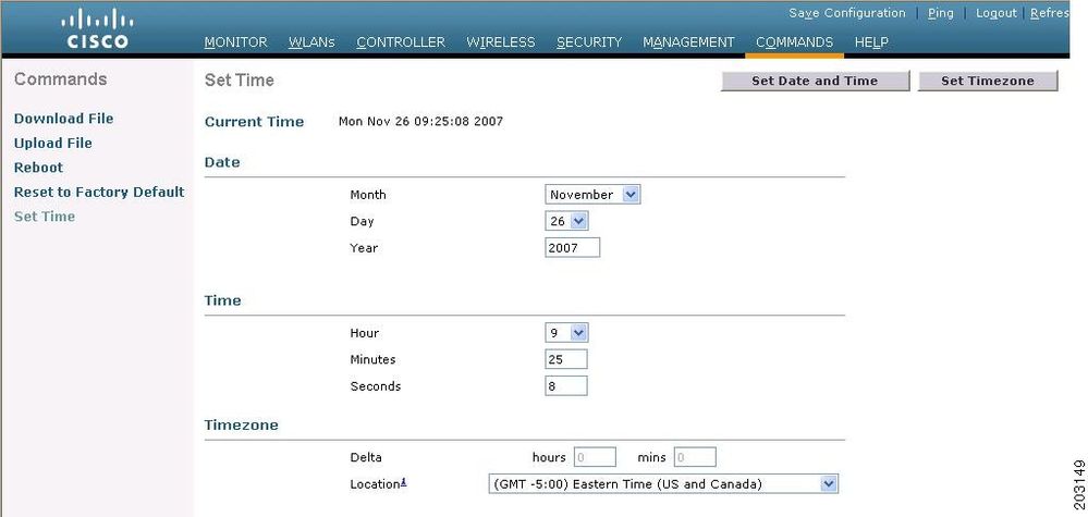

your debug show the problem and here the solution as cisco suggest.
for me this workaround worked to solve the certificate problem
(Cisco Controller) >config time manual MM/DD/YY HH:MM:SS
I disabled the ntp server and set the time manually (one year earlier)
Many thanks for your support
